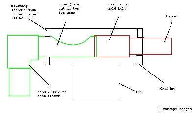

[quote="wangpushups"] It doesnt really make it a sniper if its loud and a silencer might be outta the question. Maybe.[/quote
heres a idea i had on a bolt action. the bolt is pulled back ammo loaded into teh slot and pushed back in (something on the outside like a bit of pipe glued into the tee could guide the bolt and lock it in place during firing so it wont shoot out) when the gun fires the expanding gas move through the gap in the bolt shooting the ammo

So does it combust through the tee then? It seems like it would work but how would i seal it so it doesn't blow up on me?
						Holy $H!T There's A Signature Under My Post.
						To make it airtight, you could use a repair coupling.  The one in the link is metal but pvc ones are made as well.
