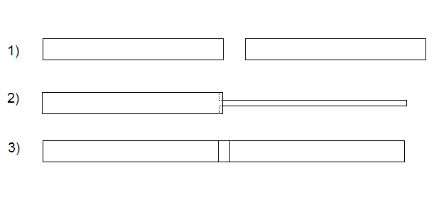

I've used both methods, but for the situation you describe as you said it's hard to get a plug that seals. You can either pour some PVA on your cardboard disc (assuming it's a tight fit) glue first, wait for it to set then pou the epoxy, but I prefer to use the following method as illustrated:
1) cut the chamber pipe in half around the point where you want the plug.
2) attach the barrel as you would do for a normal co-axial as described in my epoxy how-to, and allow the epoxy to set. The epoxy plug need not be too thick as it will be reinforced later.
3) resting them on a straight angled surface (I like to use a marble stairway) to ensure alignment, glue the two ends of the chamber pipe together with JB weld or similar. It doesn't have to be a sealed join, just enough to hold the pipe together. Once it's set wrap the join in duct tape or similar to prevent leaks and pour epoxy from the end of the pipe which doesn't have the barrel attached to it.
The result will be very strong and if you've done your alignment homework well, a bit of filler and sandpaper later and the join won't even be visible ;)

Alright, I'll do that tomorrow. Should about 3/4" long plug be enough? (overkill is fine). For step #2, I assume I will just center the barrel with supports while the glue is curing, but I can't find specifically what you mean in your epoxy casting how-to. Thanks for the detailed advice!
Wed Apr 09, 2008 12:58 am
For 1/2" copper, a 1/4" thick plug is enough, but nothing wrong with a bit of overengineering ;)
To keep the barrel cented, cut out some 1/2" disks from thick cardboard with a hole in the middle the same size as the barrel, slide them down the said barrel on the breech side temporarily to keep the barrel centres while the epoxy cures then remove them later.
