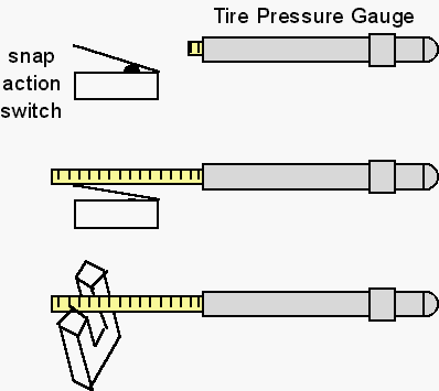

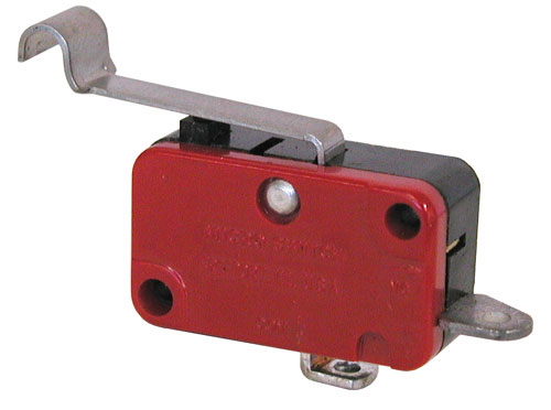

It depends a lot on what time domain you are trying to sense the pressure. If it is a slow domain, as in controlling the cycling of the gun, then you could rig up an adjustable pressure sensor from a cheapo tire pressure gauge.
A snap-action switch, or a slot opto isolator, or a home brew opto isolator, or add a small magnet to the gauge and use a Hall affect switch.
Since tire pressure gauges are peak recording gauges you'll have to modify the gauge so the scale is attached to the internal piston. A glob of epoxy should work.

- Typical snap-action switch
- SMS-228.jpg (22.17 KiB) Viewed 2696 times
- hacking a tire pressure gauge into an electrical switch.
- pressure_sens.gif (4.44 KiB) Viewed 2696 times

Anyway, I have a switch just like one example you posted it. With very light pressure it clicks on. Also I posted the stick type tire gauge in one of my first posts entitled "valve initiators" I got some stupid replies and I was thinking any way that the gauges on tire gauges like that are always inacurate. But it is a variation of the "thunderswitch" as I call it. (It's cool to name components after yourself a little but that's just what I call them.
