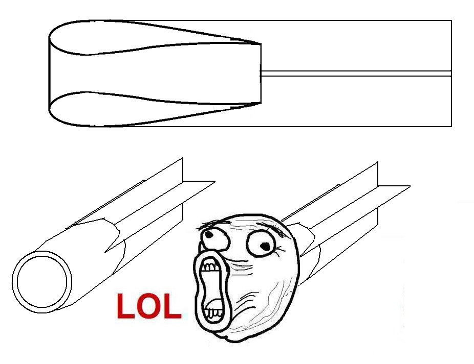

- It would probably have to be longer than this, but you get the idea...
- projectile_idea1.jpg (32.92 KiB) Viewed 35021 times

Those tools would have been helpful but there are other options for the short on cash and resources but long on patienceinventorguy1000 wrote:Thanks for the link! I didn't even know that they made those! I really want to test this theory, but I don't have a lathe, or a mill... I could probably figure something out though.
If you're putting fins on, I would avoid trying to make it spin.Is there a way to get the rounds spinning? do you think that if I turned the fins a few degrees, it would cause the round to spin, or just wobble in the air?
The fins you drew are pretty small though, I would make them much bigger, like so:

It's all a matter of where the centre of pressure and centre of gravity is, some recommended reading.inventorguy1000 wrote:So, should I make the fin length as long as the body length, or like 1 1/2 times the body length?
Here's another possible configuration, extending a rear tube with smaller fins which would also keep it centred in the barrel. As it's an "organic" shape I could see you making a wooden mold using a drill-clamped-in-a-vice "lathe" and file and sandpaper, then casting using a suitable material.
- hollow2.JPG (28.47 KiB) Viewed 34938 times

Niceinventorguy1000 wrote:Ok, Sooo... I made a prototype.
It looks like the tube isn't long enough given the weight distribution - where is the centre of gravity? Also, it needs at least some small stubby fins to keep it centred in the barrel, if it's leaving the muzzle at unpredictable angles then you'll never get a decent shot out of it.So, then I tried jackssmirkingrevenge's idea of putting a tube on the end to stabilize it, I got another old pill bottle that was bigger than the first, cut off the bottom, and the very top, and hot melt glued it to the back, creating the "tube extension".
When I shot it, it veered down into the ground the first time I shot it, and it made a wide spiral before hitting the ground the second time.
Fins inside the tube are completely useless if they are fully shrouded, what you would want for that to work is something like this:I thought about putting fins on it, but there was no room on the top, it was too snug as-is. So I put fins inside the tube, thinking that that might help, but no. I don't know what I was thinking! Having the fins on the inside would direct the airflow inside the tube and not really the tube itself, I really needed to have them on the outside to direct the whole tube. It just kept on getting worse and worse!
Since this principle is so relevant to model rocketry there is a lot to read on the subject online.Let me know what you think! and could I get some help on the calculations for the desired weight, length of tail, the CG and CP?
http://resources.yesican-science.ca/bot ... press.html
You can approximate the location of the center of pressure by making a cardboard cutout of the profile of the rocket and balancing it on a knife edge; the balance point is the center of pressure.
In terms of ideal location of each point, this is from a link I posted earlier:
The advice is for model rockets but it is relevant to spudgun projectiles tooCP--how far aft of the CG?
The exact location of the CP relative to the CG is rather a tradeoff. Having the CP too close to the CG risks having a rocket that is dynamically underdamped or even unstable. As well, since the CP for a typical rocket moves forward with increasing angle of attack, a sharp wind gust or other perturbation may result in loss of stability. Having the CP too far aft of the CG is also undesirable. This is because the rocket will experience significant or even sever weathercocking, which means its flight path will veer in a direction into the wind, rather than climb vertically. For model rockets, the rule-of-thumb is to have a rocket with one-calibre stability. Calibre refers to body diameter, so that the CP should be located one body diameter aft of the CG. Anything more than two-calibre stability leads to excessive weathercocking. Amateur rockets, which tend to be more massive (literally, have more mass for a given size) than model rockets, may require a CP further aft than this recommendation, owing to the much greater turning momentum that results from its mass. I generally aim for the CP to be 1.5 to 2 calibres aft of the CG of a fully loaded rocket.
Only useful if you want a full bore projectile, in real terms this would be to carry a payload, otherwise the benefits of subcalibre projectiles are obvious.speaking of which.. has anyone ever built a PVC projectile with extendable fins?
