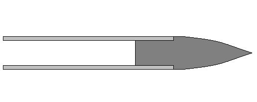

If it doesn't work, Might I suggest moving to smaller diameter (say 5mm) with something like this, using aluminium tubing as a "tail"
- 5mm subcalibre design.jpg (4.38 KiB) Viewed 5419 times

Yes you may, however it would be a little harder for me to make.
I will subtitute aluminium if it has no real benefit though.

It could be all steel with a drilled out tail, same effect - I suggested the aluminium tube to reduce the need for machining. Smaller diameter will obviously penetrate easier as there's less quantity of steel plate to displace, however you need a corresponding increase in projectile length to keep the sectional density up.

Edit: for the steel i was thinking 4140.
