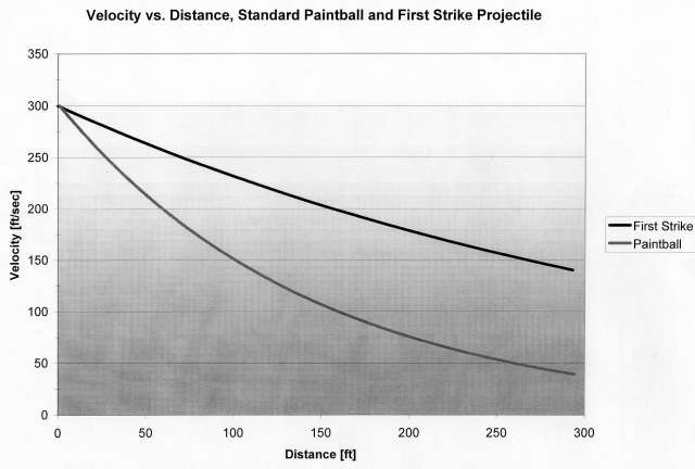

How come you don't believe that effect? The drag coefficient of a sphere is about 1.2, that of a bullet shaped object is about 0.3, this is 4 times less! You also have to realize that just like a pellet round the first strike already starts to rotate inside the barrel. Because of its hollow back the pressure from the air makes the rifling push against the sides of the barrel while it is travelling allong the barrel at the same time.
First Strike compared to a normal paintball's flight

Antonio wrote:The drag coefficient of a sphere is about 1.2
I don't know where you got that number from, because all the tests I know of show spheres to have a Cd that is between 0.3 and 0.5 depending on surface texture and roughness - and specific velocity of course, but I'm talking at relatively low Mach numbers here. Certainly within paintball speeds.
Even a flat plate, which is about as ballistically inefficient as it's possible to be doesn't quite reach a Cd of 1.2 at low airspeed velocities.
The closest ballistic shape to the First Strike is the GL ballistic model, which at paintballing velocities has a Cd around ~0.3, depending on exact velocity.
So you're close on the 1st strike's Cd, but highly off on the Cd of the sphere.
The fact it's pushing against the walls is pretty moot, because it hasn't the hardness to grip into the walls, and if the walls are even vaguely smooth in the first place, the effect in the barrel is going to be very limited.
