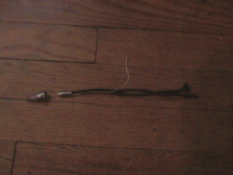

Well, I tried attaching a tail. This is what happened.
I don't think I even need to upload the video: the tail kept it from tumbling end over end, but it still didn't fly completely straight (as shown from the shape of the round after impact).
I'm thinking someone with a better gun and a more subjective way of testing this should probably try it. I might experiment with different types of tails if I have the time.

Head of the ammo after impact
Ammo used
Ammo used
