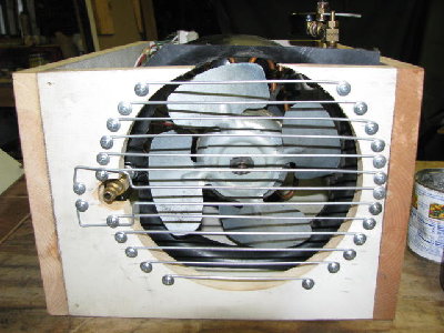

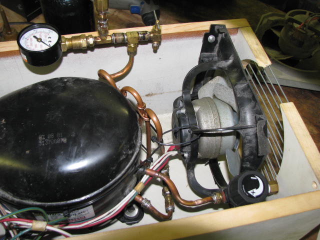

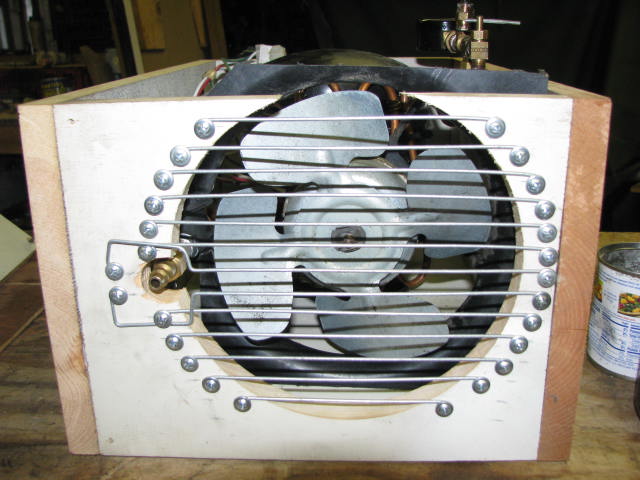

O.K. Guys I threw the old compressor away. A neighbor was throwing out 2 old fridges so I got the compressors out of them. And I think this is really funny, there was an argument in a thread somewhere in Spudfiles a while back about using fans to cool the compressors and if it would even help, well both fridges had a fan installed to cool the compressor :lol:
I got one compressor that looks like a typical normal looking compressor and it works fine, the other compressor is a cylinder about 3.5" dia. x 10" tall. well it is very low on oil so I hooked it up electrically and plugged it in and all it did was hum, I guess the piston was stuck, it was not turning, it did this till the thermal thing kicked on and turned it off. I did this 2 or 3 times and it finally started spinning, but you could tell it was pretty dry inside cause it was noisy and sounded rough and a lot of oil sprayed out with the refridgerent gas when I cut the copper lines.

Sat Mar 12, 2011 1:47 am
Looking good, I would still have the lid on and have the opposite end of the box ventilated, in order to create a duct which would increase airflow over the compressor.

Sat Mar 12, 2011 10:33 pm
yeah I just finished the lid today and will install it hopefully on Monday.
I guess it would be better to vent the opposite side, I thought I would mount the lid on 3/4" spacers so that it will vent out the top.
