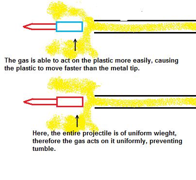

Having noticed that all your darts that look like they should fly perfectly are not doing so, took a closer look. They look like rockets, not bullets, so aerodynamics says they should fly nicely. But the one that pierced the steel plate had heavier METAL fins on the back.
That got me thinking. Are you taking into account the fact that lighter materiel accelerates more easily? On an arrow the light materiel slows the rear, making it stay straight. But an arrow ceases to accelerate after leaving the string. A gun still has expanding gas leaving the barrel when the bullet exits the muzzle.
This expanding gas could be accelerating your projectiles a little bit; if the acceleration is minor, then the heavy tip isn't moving much, but the light fins are easier to move, causing tumble. The heavier fins seemed to be more accurate, which seems to bear out my theory. The last bit of propellant is still trying to accelerate the round, but the fins are now harder to affect than the tip.

@POLAND_SPUD. What has that got to do with it? As a matter of fact, the closer the target, the less time the fins have to correct the tumble. I'm saying that the last expansion of gas sort of pops the fins, causing a severe tumble.
- graph.jpg (25.41 KiB) Viewed 7315 times
