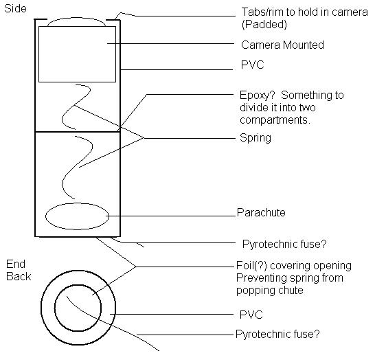

Also, I have an idea for a parachute deploy mechanism that might be effective, but I have no access to a drawing tool at the moment. I'm going to draw it on paper and upload it later.
EDIT: OK in the diagram I think the camera/spring is self-explanatory. The chute though. Pack it on top of a spring in a way that it will open when the spring ejects it. Use foil (?) to cover the end just strong enough that the spring can't break it. Lay a pyrotechnic fuse across the foil with a confirmed burn rate. Basically light the fuse, then inert it into the cannon. Fuse burns down, burns a hole in the foil, chute ejects. You can obviously put something between the chute and foil to prevent damage to the chute, and put wadding or something behind the projectile to prevent the compressed air from blowing out the fuse.
Just an idea, pleaswe feel free to ask questions, critique, and refine the idea. But if you make fun of my drawing, I kill you in your sleep.

I think you would need a drouge chute that will be able to handle any heat from a fuse or whatever

You can buy a camera for Estes rockets that'll handle rocket's g-forces (a couple hundred g's IIRC). Might be able to handle a low power spudgun's g-forces.
Camera's have also been mounted on water rockets, which also pull a couple hundred g's at launch. Wouldn't be surpised if a google search on water rocket cameras turned up some pages on using a generic digital camera with no special g-force capabilities.
The tricky part isn't so much the camera mount, it is the parachute round. A para round not only has to have a way of deploying the chute but it also needs to be aerodynamically stable. If the chute pops out as the round is tumbling like crazy you may just tangle everything up in the shroud lines.
(Springs, padding etc won't do much to change the g-forces the camera experiences at launch. In order for a spring to have any significant affect on the g-forces the spring/padding would have to be longer than the barrel.)
You can're really compare rockets to spudguns, the acceleration of a rocket happens over a much longer distance while a spudgun reaches maximum velocity in the length of a barrel. Then again, a spudgun might reach a lower maximum speed so it still would be a good starting point.
