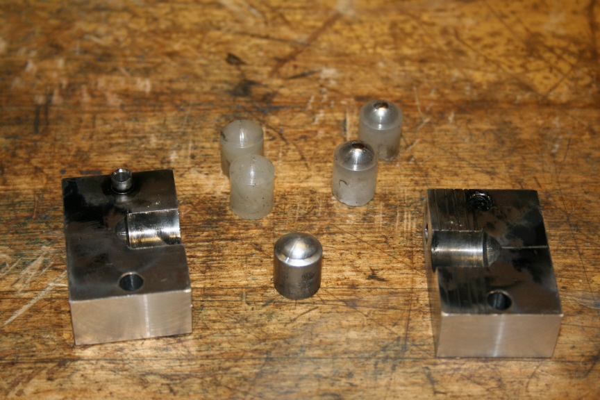

My slug mold for the copper gun, and some of the ammo produced with it.
I used a plastic injection molder and some hdpe beads to make the all plastic ones, and the others which have a 3/8" ball bearing in the front.
The last one is cast from lead, and has had the back drilled out on the lathe.
I will be shooting these today.

nice work gipp!
