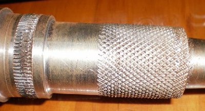

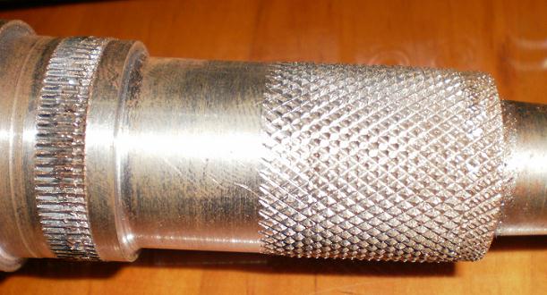

Tue Apr 17, 2012 8:17 am
Moar shiny knurled stuff!
this will also be shipped to jake :)
Tue Apr 17, 2012 11:32 am
Shineh! good work :)

Tue Apr 17, 2012 11:52 am
now I just need my own lathe :D
are you planning on making your own knurling attachment anytime soon?
You'll like the finish you can put on your workpieces :)
Polished the front piece, looks better now :)
I'm happy I was able to finish this thing, my hand hurts like f*cking hell :D
probably broke it last saturday night :roll:

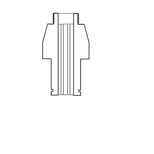

Might as well post this where it belongs...
Fnord needs a part.
Specifically a pulley insert for a drill press. Those of you who have the facilities to fabricate one will already know roughly what I'm after, since it's on top of the spindle in your drill press ;)
I'll get precise dimensions if anyone is interested, but this picture is approximately what I'm looking for. Mine is a little over 1" wide, I believe.
The only part that I'm not sure about is the internal teeth that drive the spindle. Harbor freight presumably gets around the tricky milling by casting the teeth, but it doesn't appear to be working very well.
Autogimp drawing.<br />Note that the threads are reverse threaded
Autogimp drawing.
ramses
Posts: 1679
Tue Apr 17, 2012 8:32 pm
Internal splines are a pain in the arse and generally require special tooling (broach).
