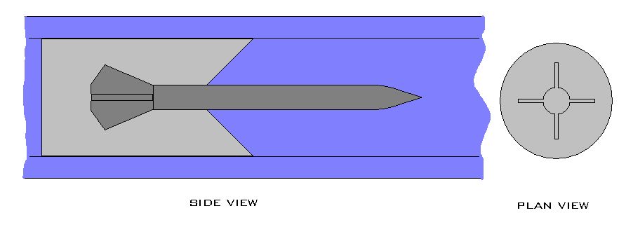

Novacastrian wrote:I think my main projectile will have a smaller diameter at the rear, i'll make the sabot to suit.
simple and effective :)
Now all we need is an explosives expert and we can make mini HEAT rounds
These days it's EFP warheads that seem to be all the rage but again, that's beyond the scope of discussion of this forum.
For those of us without Nova's impressive facilities, here's a different solution for APFSDS:
The round is basically a nail with its head cut off and three thin (1/64") plywood fins glued on with araldite. The fins are the same diameter as the barrel in order to steady the round. To make sure it's built correctly and assist mass production, it should be constructed inside a section of barrel tubing, with a jig to ensure consistent positioning of the fins at 120<sup>o</sup> to eachother. Since its self-supporting, the only sabot it needs is a flat disc that can be cut from foam, balsawood etc.

Pic of a dart i made,fired,lost,found :D I did a test shot from my .50 cal mini combustion and failed to find the dart, i found it today :P This will be fired from my Hybrid at a 6x mix, with sabot. Think it will pierce 6mm plate steel?
The object behind the dart is my old 9mm design, the new one is 4.5mm.
Edit: Sorry, the tail is made from a syringe plunger,the mid section mild steel and the tip is a 4mm allen key.
Mon Nov 19, 2007 4:09 am
looks a bit rough but n-i-i-i-i-ce nonetheless, very APFSDS :) what does the sabot look like?

Very funny indeed :D I have yet to make the sabot, i tried to make a design like the anti tank but my lathe can only hold 8mm dia, that design will have to go to my 33.7mm combustion :cry:
Share your design for a simple sabot? This is a small "flachette"!
Mon Nov 19, 2007 4:26 am
The simplest way of doing it would be to have a one piece cup sabot.
