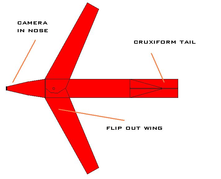

how's this for complicating your life, make a spudgun launched glider with flip-out wings or a scissor wing - it will be heavier, so less acceleration meanign less stress on the camera, plus it has the potential to fly a lot further.

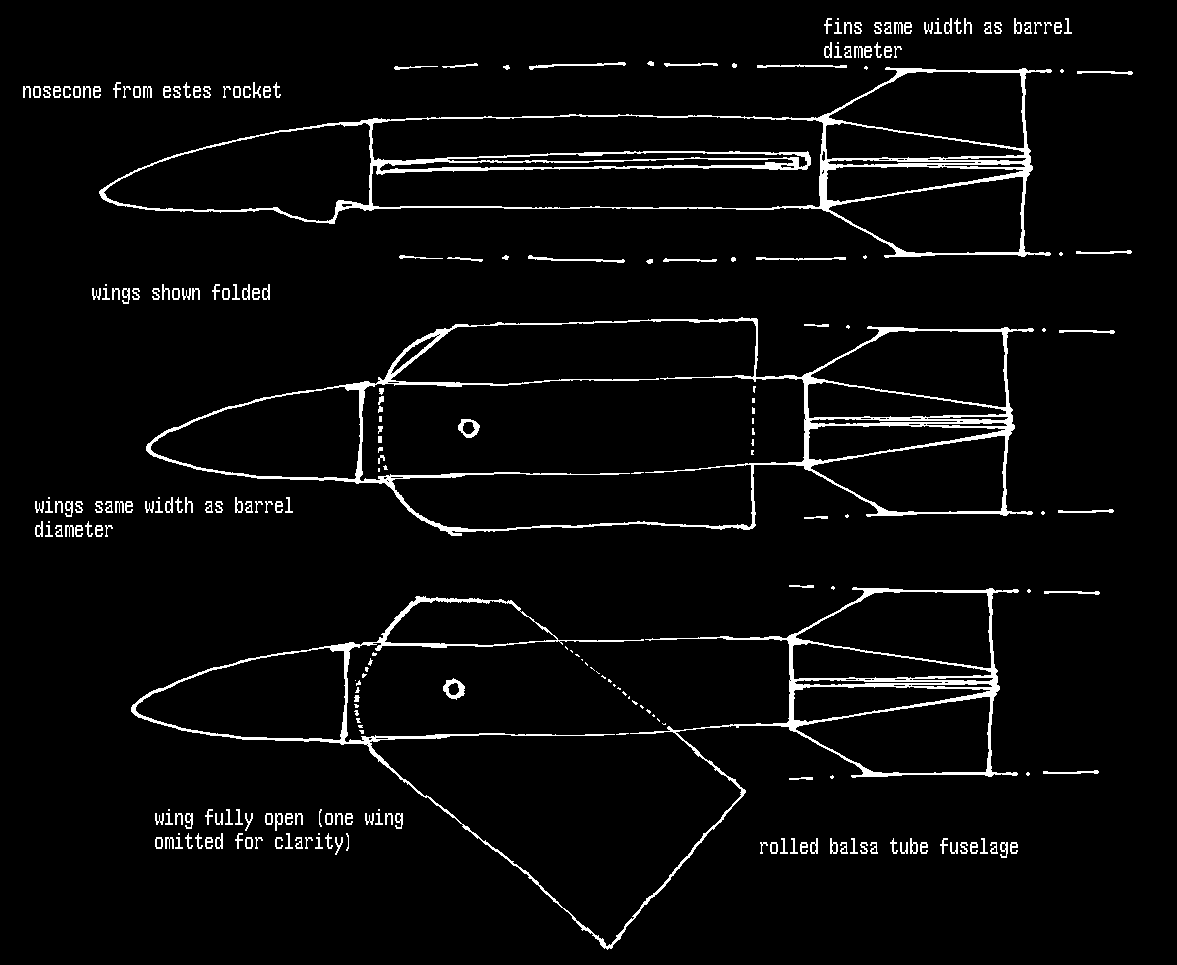

JSR i LOVE that design, and i could make it too!!, could it be made out of wood such as pine or even balsa then add wieght to balance it?
Thu Dec 06, 2007 12:14 am
Carlman wrote:JSR i LOVE that design, and i could make it too!!, could it be made out of wood such as pine or even balsa then add wieght to balance it?
It can easily be made out of balsa, the fuselage could be a section of thin balsa rolled into a tube, quite easy to achieve and the result is very strong and lightweight. I improved the design slightly, in this way the wings and the fins act as stabilisers in the barrel (which also serves to keep the wings closed) - though of course you'd need a sabot of some sort to seal the air.
To open the wings you can use internal rubber bands that pull them out, as with this design. Ideally the wings should open when the glider reaches maximum height, you can do this by using relatively weak rubber bands and a locking mechanism that keeps the wing open once they do. This way, air drag will prevent them from opening out too early, and they will then be prevented from closing once it starts to accelerate again.
edit: interesting links there dewey, electro-chemical eh? I guess when the rocket starts pointing downwards you could have some acid spill onto baking soda creating enough pressure to blow out the chute...

yea that design worx for me im pretty handy with a chisel and a stanly so balsa would be ideal for me. that baking soda and acid seems the easy way to go rather than a hard to get pyrotechnic fuse (damn oz). why would you want to have the wings open at maximum altitude thats also when the chute opens thus rendering the wings useless or so i would think, are they to reduce spin? or what is there purpose?
and by the way are you involved in tech drawing for a job because they arnt just some thrown together 2 minute plans there
Thu Dec 06, 2007 3:02 am
You got me wrong, I meant that a winged glider could be used as an alternative to a parachute, not in conjunction with. The idea is that while it's rising, the wings are closed so the projectile is aerodynamic and flies quicker up to the maximum altitude, at which point the wings will fold out (because it's moving slower and there's less air drag keeping them shut) and the unit will glide to earth - a little swiftly, because presumable the wing loading (area to weight ratio) will not be so low, but safely enough.
Actually they were :) I'm a laboratory analyst by trade, but I do like to dabble in technical drawing. The plans were sketched with a pen on paper, I then took a photo with my digicam, opened it with paint and saved it as a monochrome bitmap, inverted the colours to give that "blueprint" look et voila :)

would it 'glide' and hit slow enough to preserve the camera though?
