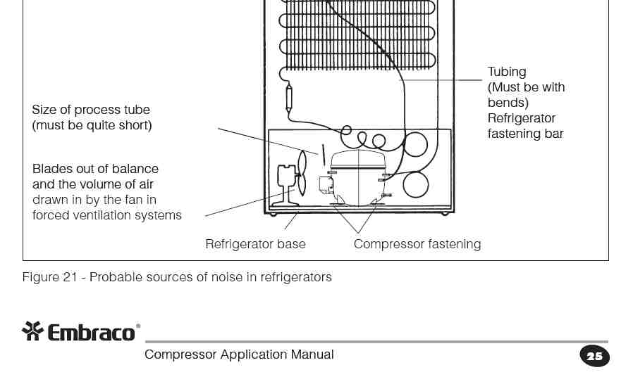

Did you ever see a fan installed in a refrigerator or a/c unit directed at the body of the compressor?
yes. See the diagram, its from an Embraco service manual. A bog standard compressor just like mine, in a normal refrigerator. This is the third time I've said this, read the manual, forced air cooling is perfectly normal and recommended by the manufacturer.
The point is though that the outer casing gets hot in use, because it is heated by the internal workings, and by blowing air over the casing and cooling it, by definition you are also cooling the internals.
Exactly, the oil sump it's sitting in keeps the internals in better thermal contact with the casing facilitating this.
taken from embraco service manual

http://www.embraco.com.br/portugue/prod ... EF_ing.pdf
6.1.7 Compressor cooling type
Smaller compressors, with relatively low power motors, can be used in a static cooled arrange-
ment. Compressors with higher power motors require forced ventilation. Some compressors in
the E and T series are also available with an oil cooler. This oil cooler is a coil positioned in the
lower part of the housing immersed in the oil sump. (See “2.7 - COMPRESSOR COOLING
TYPES”).
IOW If the compressor was designed to be fan cooled in an enclosure, it will come with a fan and/or an oil cooler coil.
Have you ever seen (in person) a refrigerator or a/c unit that came with a fan? I have never seen one and I have seen many, many units.
