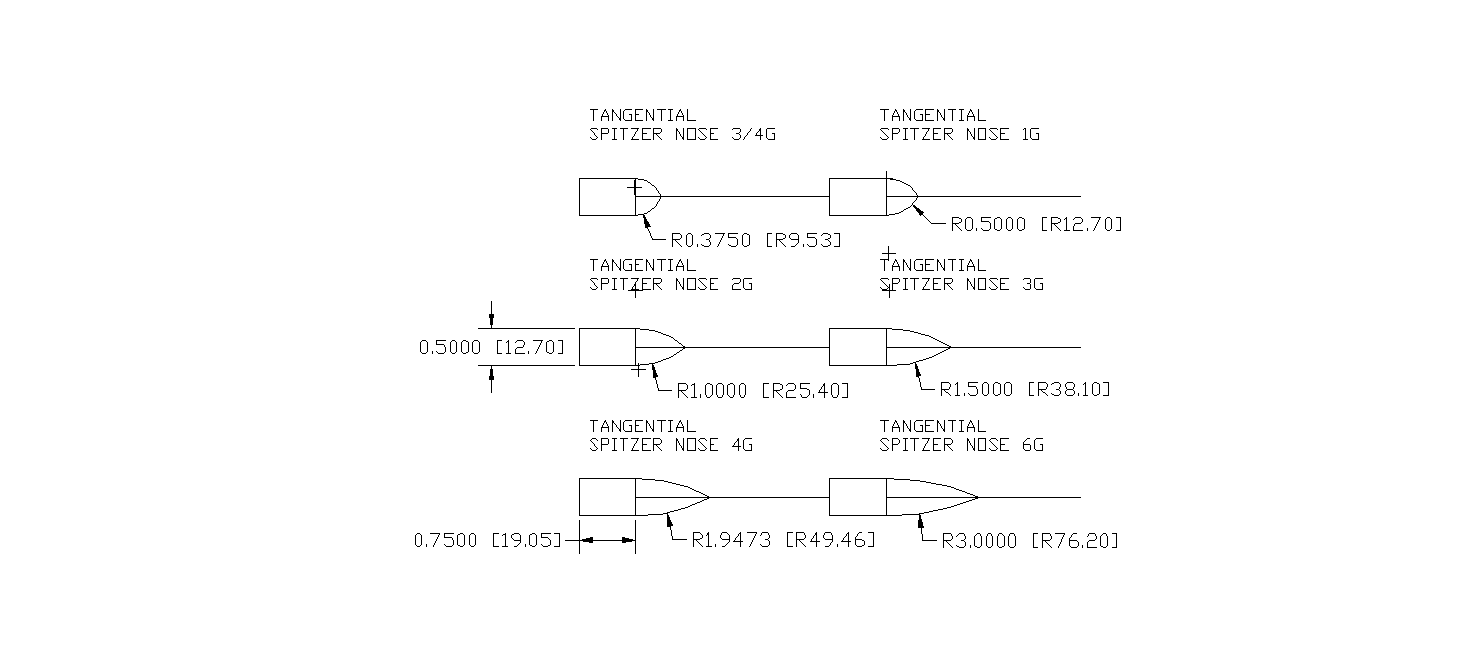

Use the following drawing as guide for dimensions and ratios of caliber to nose radius and projectile length.
Have you considered brass tubing as the hollow base and use epoxy and a lead or steel ball as the tip?
add link:
Why attempt rifling first. Get a good projectile that is drag stabilized first, check it for accuracy and range and then proceed to your rifling dream!

First it was 7.7mm length, then 1.27mm caliber.
I give you a drawing for caliber to length ratios to answer your question and you do not even appreciate that.

dewey-1 wrote: Well maybe you should also read your own posts to verify which language you are using.
Thats the price I have to pay... converting from imperial to metric units... and then back. No wonder I make mistakes... but thank you for pointing them out to me.
And thank you for the drawing.. I didnt even take a look at it yesterday so how could I appreciate it?
