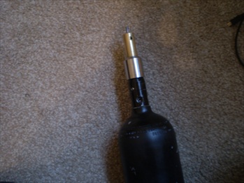

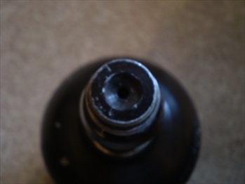

Gippeto wrote:Goats....are you planning to remove the pin valve from the regulator?
i have done that im gonna put pics on now i forgot all about this :roll: Any tips on painting aluminium tanks? i was thinking of etch-primer-spray-bake?
Perfect!
Perfect!
Pin valve removed
Pin valve removed
Attached to crosman valve
1/2" NPS
1/2" NPS
Spring seat
Spring seat
9/16 - 18
9/16 - 18
100% free
100% free
