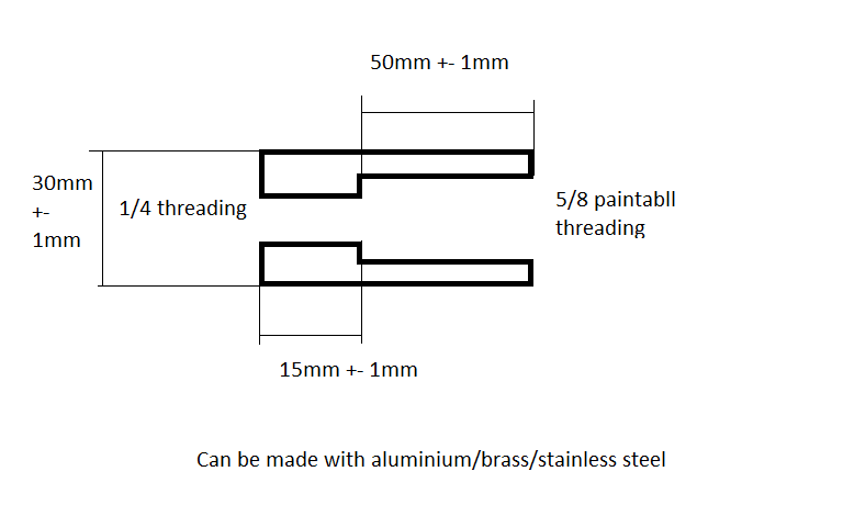

Need this piece made
I can pay by bank transfer, paypal etc.
I live in Portugal.
Pm me for details.
I live in Portugal.
Pm me for details.
- Part.png (12.22 KiB) Viewed 4759 times
I could do it in brass for say €15 posted but I don't currently have a 5/8"-18 tap so I would have to order one, that would add about €10 to the price and increase waiting time. If you don't get a better offer and still want the part let me know.
