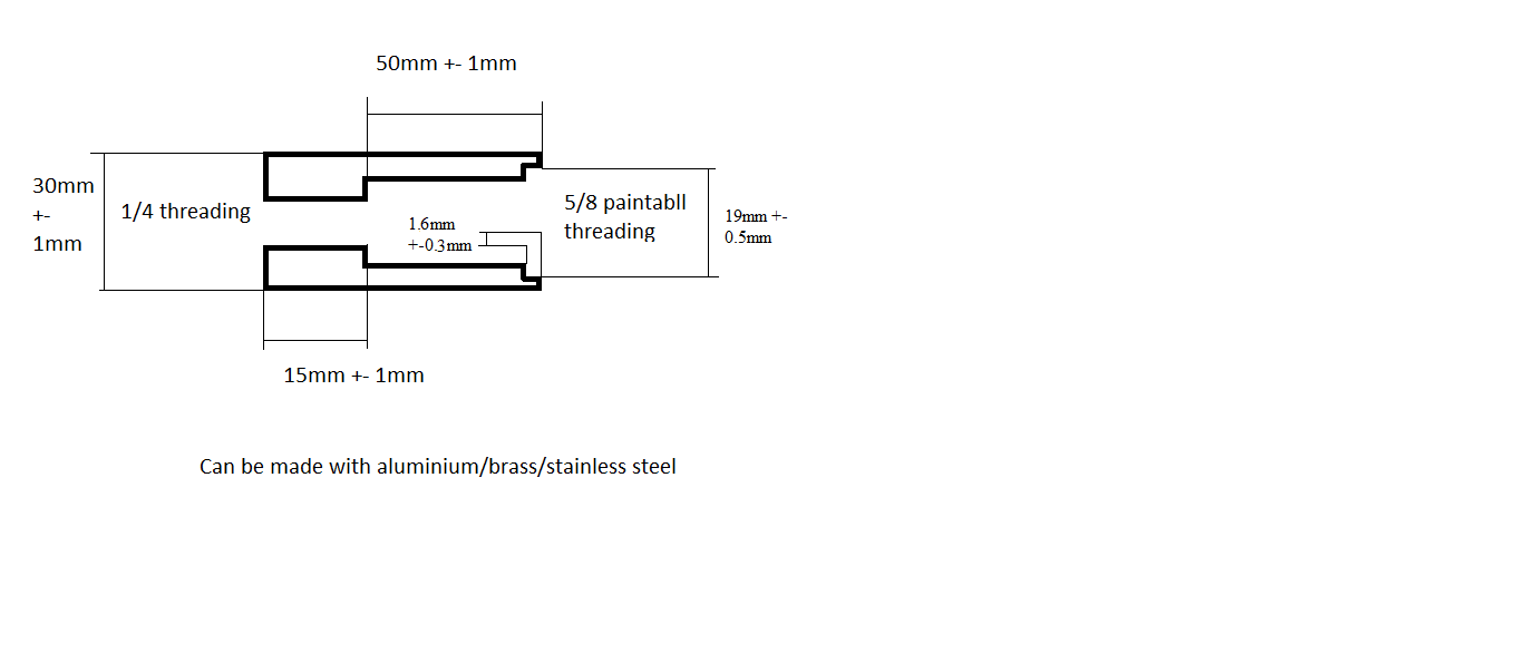

Hum but you can do a lot custom parts with the tap (I´d ask for a couple more of these later :P )...
So how about 20 euros?
Fri Nov 23, 2012 8:40 am
You caught me in a good mood because it's Friday ;P 20 euros, but you will probably have to wait about a month till I get the tap, make it and send it. If you're fine with that I'll go ahead and order the tap.
How deep do you need the 5/8" threads... for the whole 50mm? Or is say 30mm enough?
Also, is the 1/4" thread you mentioned 1/4" BSP?

I'll need need to see the 5/8, it need to fit a pt regulator. Yes 1/4 that we use around here (Well a mouth from here it´s xmas, it would be a great present to myself :D ). I can wait. Thanks

To thread the whole part I would need to also buy a bottom tap:
That would not make it worth 20 euros.
A normal tap only will mean that around 5/8" from the end of the hole would not be fully threaded:

30mm it's enough :), and a little chamfer in the start of the threading for the oring. Same as a paintball tank.
Fri Nov 23, 2012 11:28 am
Can you give me the o-ring diameter (as installed)?

I don't really need a groove for the oring. Can you check one of your paintball regulators? I just want to install one on it. I'd measure the oring but I'm not home now
Fri Nov 23, 2012 11:41 am
If you want the o-ring to seal, you need a recess to be cut for it, it won't seal on the thread. Don't really want to take my tanks apart...

Edit diagram:
(A 45 degree 1.5mm chamfercould work too, maybe easier to make? )

wyz2285 wrote:(A 45 degree 1.5mm chamfercould work too, maybe easier to make? )
Boring a straight section slightly undersize to the o-ring will work better and be easier do make.
It's the method used here ;)
