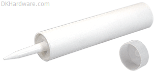

Hey MrCrowley,
I don't know if you noticed, but while I was searching some material for the sabot I noticed that sealant cartridges are a perfect fit for your 48.5mm barrel. At least the ones that hang around in my house
- sealant_cartridge.png (16.57 KiB) Viewed 4012 times
