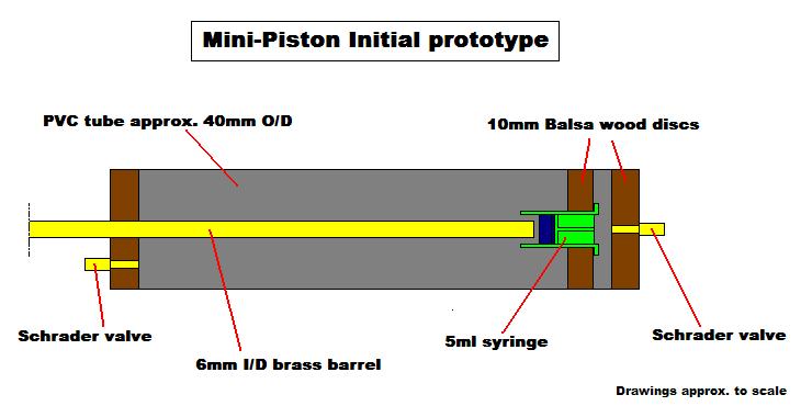

I can buy reducers but never used one, always preferred to cast my own fittings out of epoxy. When you make your own parts to your specifications you can make your launchers much more efficient and compact.
My first co-axial was built in the same manner using balsa-wood discs glued on with Araldite.

Your obsessed with syringes jack!!!!! Do you get them from your pharmaceutical company or something?
Poo.
Wed Sep 12, 2007 3:19 am
They're pre-fabricated pistons that cost next to nothing, what is there not to be obsessed with :D
These days I do "borrow" a few from work but before I used to buy them from a pharmacy, it helps that I'm dating a pharmacist too ;)
