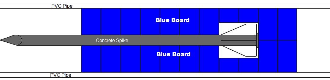

So, how man layers of blue board should be beneath a .5" x 18'' iron nail? It's very heavy and fins protrude from it. My design, based off of your idea, has 2 layers of the foam. I have a diagram. I'll attach it when I get home. Proxies can't upload images.

How thick of foam are you using? How much PSI is the gun going to be charged with?
Most cases I would say a layer of two inch think foam would work fine. The force of the air is going to exert a constant pressure on the object no matter what the weight of the object is. This is true in pneumatics any way. In hybrids and combustions its a bit different as the weight of the object will increase the pressure the combustion creates as it takes longer for the object to move down the barrel.
Are you forming a cup around the object? Or are you using the foam as wadding?
I'll look forward to seeing your diagram

It's a combustion, and I want to use the two inch like you suggested. But if hardware stores sell thicker sheets, I'll use that. I'm using the sheets to form a piston behind it and a sabot over it. I may possibly attach them together to make a single sabot.

Here's that diagram that I was talking about. It's more or less to scale too. However if 1/2 in board is the biggest they sell at Home Depot, (which is where I was planning to go) I may have to reconsider the design. That is a lot of cutting...
- This design is assuming I can find 2" blue board.

That will work just fine...I think it must be a location thing because most hardware store where I am sells at least one inch. 1 1/2 inch isn't uncommon either.
I haven't done this before but you might try streamlining the sabot a bit...it should still separate just fine but you might gain a bit...
Another thought... you can probably get by with only a few sheets of blue board in front of the fins. The brunt of the force will be taken up by the rear and the sheets in front just serve to hold the object centered in the barrel. As log as the rear has a pretty good seal all the front end does and make sure the object stays centered in the barrel...
When you get it all done could you post a vid... I've been meaning to make one but its just to dang cold right now...
