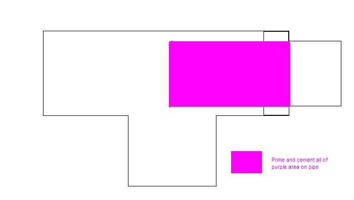

Hi,
I'm now in the process of putting the parts together for my first cannon. I've modified my PVC 4x3" bushing, but now I'm about to solvent weld it to my PVC 3" barrel. Yes, I know the process, but I'm not sure how to do that with a modified bush and barrel. Apparently you have to slide the barrel into the bush, but I'm not sure how to do that without making all my cement dry. I thought of cutting my bush up & solvent welding it back onto the barrel, but realised that it wouldn't fit (LOL).
Any of you guys who has built a piston cannon can care to share?
Thanks.
How to solvent weld barrel to modified reducing bush?
What I do is place a liberal amount of cement on the modified bushing, and then put primer and cement on the barrel up to the point where it will be seated.
- untitled.JPG (12.95 KiB) Viewed 2788 times

1) slide the pipe through as a dry fit and mark where the weld will be
2) take the pipe out and apply primer to the marked area and the inside of the bushing
3) apply glue to inside of bushing and primered section of pipe (more so on pipe)
4) slide pipe into bushing so that the desired area is in the bushing.

Why don't you slide the barrel in, after priming both surfaces, get it to where you want it then slide the barrel out a few inches apply a liberal amount of cement and then slide the barrel back into the bushing to where you want it and twist until it won't turn anymore...
