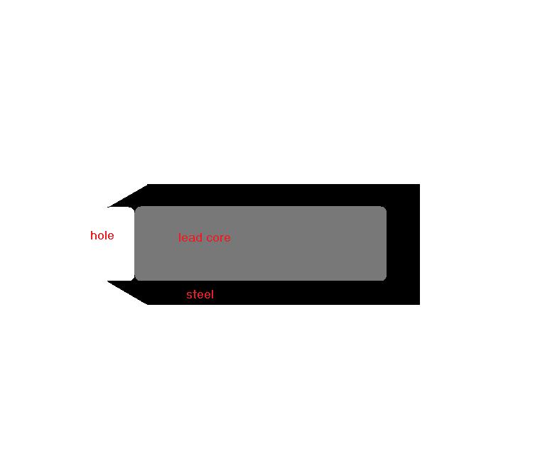

i want to make somekind of "hunting" bullet that expands like a rifle bullet does to do more damage when hitting a animal.
the pic is my thought and the target would be a tree.
i would like to shoot a tree and find a nice and clean entry and a completely blown apart exit and ofcourse the BIG hole.
2" diameter soft steel with a hole drilled in it and filled with molten lead almost to the top.
do you think this would have a chance to do any damage at mach one?
and if i cut grooves down the sides of it will it expand and become a mushroom(?) shape?

You basically just described a normal bullet, although, I would see about using a softer material than steel, say copper pipe?

ok then i use brass as the casing.. is that a better choise?

Brass would work fine, I just suggested copper because it was cheaper (but I forget, your launcher costs $1200, so price really isn't a concern for you).

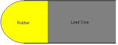

Speaking of bullets, there is a company (I believe Federal) that makes a jacketed round that expands nearly 3 times its normal size. It is a normal jacketed bullet with the addition of a piece of rubber near the tip. Upon impact, the lead pushes the rubber, which makes the shell expand more.
That may be an option you could consider.

okay but a spudgun is no rifle, it won't treat that lead like playdough, hollow tip are for guns with the power to go straight through a body or two

and 10x and 200gram ammo is for guns that can blow five persons in half
i go to the machiner man here "not Larda this time if i do it here i can get rid of those huge shipping costs" and get him to make the shells out of brass.
any imput will get tried

i probably just find a long casing thing of soft metall and cut them up in piececafter i have filled it with lead.
after that i just drill the lead core out about 1/2" in there to get a hollow point

Why not solid lead? It would expand a lot more.
I was just about to say that. So, agree!judgment_arms wrote:Why not solid lead? It would expand a lot more.
A solid lead chunk would do the trick.
Why the casing?
For a hollowpoint to be effective, first of all you have to ensure it hits nose-first, that means either rifling or a hollow tail/fins.
Secondly, hollowpoints rely on velocity to expand when impacting with soft targets while still driving through the target, in your case it will probably be so heavy that it will just flatten out on the surface with very limited penetration.
As was pointed out, a solid tip will improve aerodynamics, keep the CG forward and aid expansion:

then i will use fins on them.
mabe make them small and sabot them to make them go as fast as a "slow" speed fire arm.
i can get 5.5 30-06 up to mach two and that is 50grams.

Why use small bullets and make them expand when you can just usea bigger heavy slug in the first place? The whole idea behind expanding ammunition is to make a hole bigger than the original diameter of the projectile - if you're using a saboteb bullet, it's defeating the (hollow?) pointmabe make them small and sabot them to make them go as fast as a "slow" speed fire arm.
