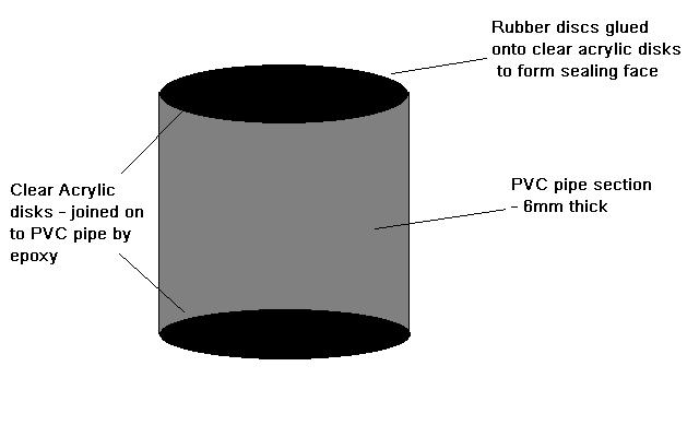

limbeh
Posts: 128
Joined: Sun Dec 30, 2007 10:52 pm
Fri Aug 22, 2008 9:56 am
Hi,
Here's the design.
Pretty simple actually. A simple cylinder. Only question is whether PVC can be glued to acrylic and withstand pressure difference of about 8 bars.
The inside of the piston should be hollow, unless it can't withstand the pressure difference. Which in that case I will probably just fill it up with silicon sealant.
Thanks.
Piston construction
Piston construction
piston construction.JPG (19.98 KiB) Viewed 2123 times
Fri Aug 22, 2008 10:45 am
The right epoxy prepared well and applied to a properly prepared (roughened and cleaned) surface will do the job.
brogdenlaxmiddie
Posts: 562
Joined: Sun Jul 22, 2007 2:19 pm
Fri Aug 22, 2008 11:00 am
THE EPOXY GOD HAS SPOKEN! hahahaha, but seriously, you'd be fine with your design, just don't forget the bumper!
Fri Aug 22, 2008 3:18 pm
The pressure isn't the problem, it's the bumper. As long as you have a good bumper you'll be fine.

Sat Aug 23, 2008 9:09 am
As expected, the very mention of epoxy brought jackssmirkingrevenge out - precisely who I'm looking for.
Jacksmirkingrevenge, from your experience, do you know if marine epoxy is better than normal Araldite epoxy?
I suppose 3mm thick 75 deg rubber isn't soft enough as a bumper. I'll probably be using a lot of old mousepads instead.
Thanks!
