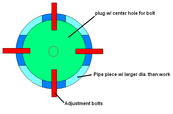

Most drill chucks aren't going to hold your work piece very well, plus you have to support the other end of the work piece if its relatively long. Here is a homemade chuck I used to use before I bought my lathe. The center bolt is small enough to fit into a 1/2" drill chuck.
homemade chuck.PNG (7.98 KiB) Viewed 5825 times
