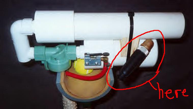

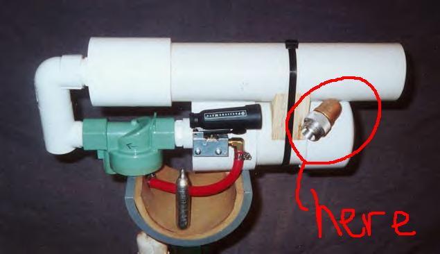

Alright -
I was looking on spudtech.com the other day and say a small gun, called the "TBL250LP", used to launch tennis balls
It had a 12 gram CO2 adapter glued directley into the chamber.
The pictures are indistinct, but it looks like a steel threaded piece sautered to a copper elbow
does anyone know if these adapters are available commercialy, and if so, where?
i would love to add a CO2 cartidge to one of my pnuematics without having to buy the $60.00 gun.

http://www.tippmannparts.com/index.cfm? ... goryID=139
This screws into an ASA. Most ASAs end with a 1/8" NPT thread.

unless your gun is copper steer away from CO2 it makes PVC brittle :shock: because as CO2 decompresses it cools everything, so its like taking the gun out and firing it in the snow.

But wait - does the quick change adapter screw directly into 1/8 NPT, or does is go through the ASA fitting???

The quick change adapter will come in two pieces; a cradle for the cartridge and an adapter to connect the cradle to the ASA. Screw the adapter onto an ASA first, then screw the cradle onto that.
Most ASAs have an output of 1/8" NPT, which can then be connected to normal pipe threads.
twizi wrote:does that adapter have a valve on it if so how do you get it to release the presure
The adapter has a pin in it the punctures the CO2 cartridge when it is screwed down.

Found it - adapter at http://www.totalpaintballgear.com/produ ... ter--.html
ASA to 1/8 NPT at http://www.palmer-pursuit.com/cart/inde ... cts_id=223
