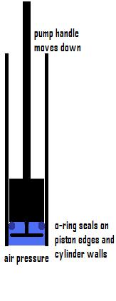

Actually, the force to seal comes from compressing the air. The compressing air, forces the o-ring against the solid ledge of the piston, and also against the wall of the pipe.
But I'll agree, it does help if the o-ring is at least touching the pipe wall initially.

Just for fun I made this diagram of a floating oring piston.
- floating oring..jpg (9.02 KiB) Viewed 3528 times
