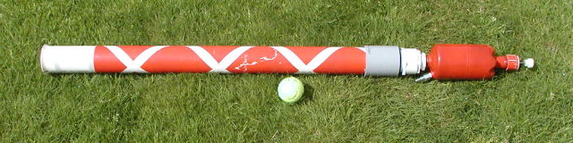

On a air cannon, I use a thinwall 160 PSI thinwall 2.5 inch to toss tennis balls with the :!: Dare I say it.. :!: Marshmallow Cannon.. at 100 PSI.
Sorry had to do it.
On the big launcher the 2 inch QDV T shirt cannon, full soda cans are launched at up to 80 PSI with no issues from the 7 foot barrel. I haven't tested it in the golfball size, but I have had no problems with it in the tennis ball size.
Thinwall tennis ball barrel tested up to 110 PSI on the air cannon.
Tennis ball barrel1.jpg (36.58 KiB) Viewed 4040 times
