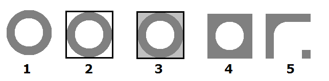

Is it possible to melt down PVC and mold it around existing dry PVC? Will it adhere properly and retain reasonable strength?
The picture should explain what I'm trying to accomplish.
The darker circle is a length of pipe, the black square is the mold. The lighter gray is liquid PVC.
(Step 5 is irrelevant, it's just what I plan to do with a section of the square stock after I make it)

I have tried it before with other things... Doing this would be a close to impossible task. For starters you would need to apply even amount of cointious heat to the pvc for it to melt... When it melts it is nearly a liquid and it hardens REALLY fast (im talking seconds here)... It would be preatty cool but extremely difficult to achieve... if yuor gonna do this you might just wanna get a pvc rod and drill a hole of your disered diameter...
If you do get it which I'm predicting you wont... you will have a Solid SEAL ... I think this is called thermobonding and it's as if you got a whole new piece of pipe... So if you do try it good luck and try not to get it on your body beacause it BURNS.
hope this helped

Ah, I wasn't aware of that topic. I guess I'm better off doing this with epoxy or even bondo. I just thought PVC would be more convenient since I have a ton of it. Thanks for the tips.

PVC is a thermoplastic so yes, this is possible. But generally you can't form it well in that state without the proper molding equipment.
The "pressure rating" theBOOM mentioned is maximum shear stress mentioned on the package (as far as I know) which is not the same as maximum pressure differential. Generally the maximum stress in the material is far higher than the maximum pressure differential. Also, shear stress is only one type of stress, and safety factors are essential.
I'd suggest either working with something like epoxy or starting with square PVC rods and using a lathe and/or mill to get what you want.

It has a very narrow temp band between viscous and carbonizes.
Softening Starts, (approx.) 250°F
Material Becomes Viscous 350°F
Material Carbonizes 425°F

All my work bending and and forming PVC pipe and conduit, I have never seen the "viscous" state. It goes from being pliable like a garden hose to toasted with no liquid or flow state in between.
There are many formulations of PVC. It is all the way from soft children's toys, garden hose, bags, to hard pipe.

I doubt he is making a bracelet for the competition. The hole is bent 90 degrees. The finished material is a solid block with an elbow section inside it.mark.f wrote:If you're looking to make a bracket, why not make up some sheet PVC, and then make a jig to bend it at a 90-degree angle?
I've never gotten PVC pipe to flow as a gel or liquid ever. I can't see any way to make a mold and pour it in. Not going to happen. It softens and becomes pliable like a garden hose, and if over heated, toasts, or scorches like a marshmallow. Examples of bent PVC below.
