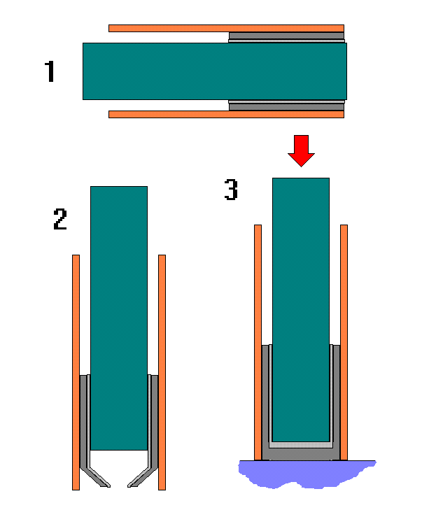

Uses aside, here's some advice on making a buckshot sabot
1) Take a mandrel that's a few millimetres smaller in diameter than your barrel, wrap some paper around it then tape until it fits snuggly in a section of barrel material.
2) Move the mandrel out a little and fold the edges over.
3) Place the barrel tube over a hard surface and hammer the mandrel down to compact the edge and make it stiff enough to resist firing.
Pour your BBs in and you're sorted.
Inanimate targets only ;)

Anything of the right size that can take being hammered. 12mm drill bit for example :)

For shot shells, there's this as a possible solution: http://www.glbarnes.com/shot_shells.html

Ragnarok wrote:For shot shells, there's this as a possible solution
Basically what I suggested ;P
Ragnarok
Posts: 5401
Location: The UK
Thu Nov 12, 2009 8:24 am
@Jack: Essentially, but I doubt it will hurt to have a step-by-step photo guide.
