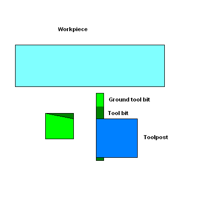

Here is a simple way to finish a piece of work. Use a 90 deg end on a tool bit and grind the top face at an angle so that it looks like the square in the drawing as the working face is toward you. Feed it very slowly until it starts to get a little bit of swarf and then run it along the work piece.
This toolbit will give you a smooth finish on your work.  Adjust so that the center of the bit meets the work piece.
Finishing Bit.PNG (5.65 KiB) Viewed 1786 times
