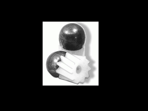

Here is probably the most ideal, consistent and accurate projectile you could use for a smoothbore home built launcher!
You can not home build one for the price of $.65 each.
This one is for .740 inch bore. (18.796mm) to be exact.
19.00mm nominal size or .748 inch bore.
Here is a link for USA;
http://www.midwayusa.com/viewProduct/?p ... ber=557135
BPI AQ Slug .740 inch OD Fins
Wed Mar 24, 2010 2:49 pm
Good find, and not that expensive either, 100 for $65 isn't such a big deal (unless you've made an autocannon :roll:) for the dedicated enthusiast.
They will probably leave the barrel of your average pneumatic at a fairly low subsonic velocity, so trajectory could be expected to be a bit howitzer-like at longer ranges, however even at say 500 fps keeping all your shots on a saucer at 50 yards should be no problem with a consistent launcher and reliable sight setup.

Ooooo!!! Those are cool. And I have a new hybrid. Looks like I need a 3/4 inch barrel.
They really aren't that expensive too...

The optimal barrel for these would be 3/4 inch Copper Type K which is the thickwall version.
The ID is .745 inch nominal.

Maybe with a shotgun wad it'll fit the co-ax...Hmmm.
Something to think about, but they are awfully light at only 1 oz.
