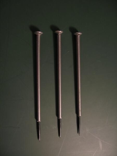

He may be able to throw this dart but i doubt it would fly straight at 900 fps.
http://www.roundofnine.com/my_darts.html
16d nail dart.jpg (12.72 KiB) Viewed 3117 times

Yes, but I get the feeling that those darts owe their stability to the thrower's technique, either by imparting spin to them as they are thrown, or by allowing them to tumble end-over-end at a specific rate, much like a throwing knife.
So far as the center of pressure is far enough behind the CG, the dart will be stable. The only exception I can think of when it comes to high velocity, is darts that arn't structually sound enough to maintain their shape at speed. That, and if you go supersonic or start to approach it a normally stable dart could become unstable. Weird things happen when shockwaves and transonic aerodynamics come into play.

at 900 fps, the pictured darts might tend to cavitate.
The nose would push the air away from the dart for the rest of the length of the dart, so that there is minimal drag on anything but the tip. The rest of the length would not contribute to the drag, so the COP would be the tip, forward of the COM.

The dart shown will usually fly straight at low speeds.
It is a frustrating exercise in trying to design a nail dart capable of 900+ fps.
Even 600-800 fps is not easy.
Low speed darts may be made with rolled paper cones.
However at 600 psi these will blow out.
Sabots for a nail in a 3/4" barrel are another challenge.
