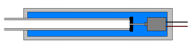

i have been thinking about using one in a mini coaxial as the piston that seals the barrel, that way you dont lose any air to a pilot chamber
Sat Jul 10, 2010 4:21 pm
spikerbond wrote:i have been thinking about using one in a mini coaxial as the piston that seals the barrel, that way you dont lose any air to a pilot chamber
Something like this? It would work, the solenoid needs to be strong enough to pull away from the breech though. Once it does however, no more differential pressure keeping it shut so opening time should be excellent.
For a 6mm barrel at say 150 psi, the solenoid would need to pull around 6.5 lbs.
Hmm, for a 1mm barrel at 800 psi the force is less than 1 lb...
Gun Freak
Lieutenant 5
Lieutenant 5
Posts: 4971
Sat Jul 10, 2010 4:29 pm
Alright Jack, you normally build everything first so why stop here :wink:
Also, you think there is a way to balance it so it doesn't have to be as strong?
Sat Jul 10, 2010 5:07 pm
Gun Freak wrote:you think there is a way to balance it so it doesn't have to be as strong?
Then you'd basically have Tech's tried-and-tested QDV design, but with electric actuation instead of manual. All you'd need is enough force to overcome friction.

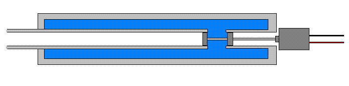

Sat Jul 10, 2010 7:23 pm
This is what I meant:
Gun Freak
Lieutenant 5
Lieutenant 5
Posts: 4971
Sat Jul 10, 2010 7:26 pm
Oh ok, that would work too. You gonna try something like it? Itll probably need a bumper too.
Sat Jul 10, 2010 7:30 pm
Not directly, but what I've put forward here is along the same lines, only using a servo instead of a solenoid.
