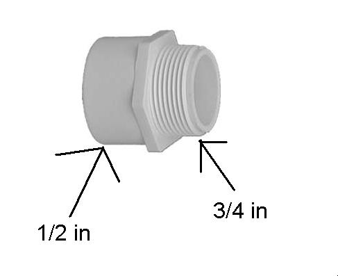

is there an adapter with a 3/4 thread and a 1/2 adapter? if so where can i get one?
this is what i want
3/4 thread to 1/2 coupling adapter

Male or female, theres one with 3/4 treads on the outside and a 1/2 slip on the inside, if you want one with the 3/4 thread on the inside buy a slip thread adapter and glue a half inch bushing inside

You need to state the gender of the threads desired on each end. A threaded reducing bushing is one item that can be used. A threaded coupling can be used. One has male and female threads, and the other has only female threads.
You mentioned coupling, so I presume you want one of these that is 3/4 to 1/2. They exist.
Edit, saw your updated post with the photo. I have not seen one that size in PVC. You can use a 3/4 inch fitting with a 3/4 to 1/2 reducing bushing in it.

Yeas they make those I have bought several, I get them at lowes

I have them too, very common fitting at stores.
If you have a Menards around, I know they have em.
