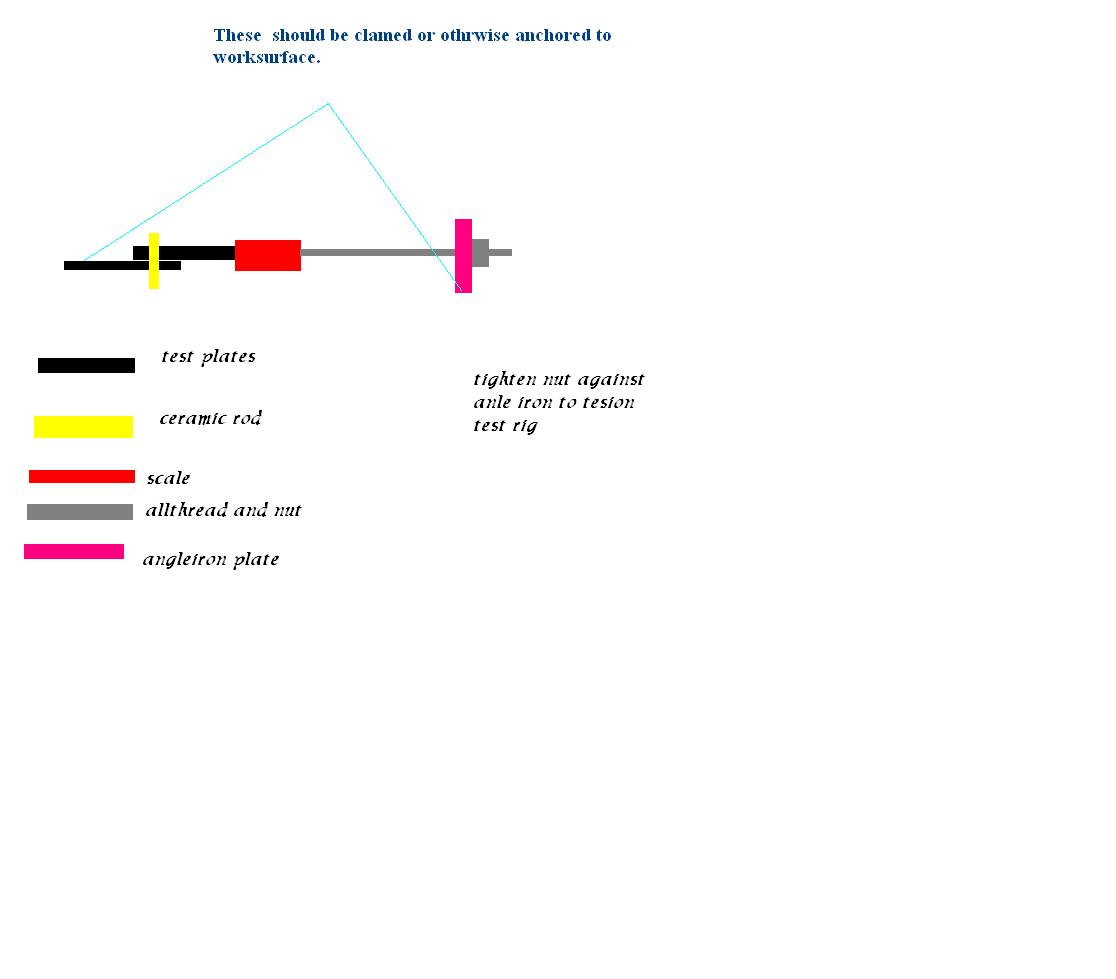

Testing shear strength shouldn’t be too difficult. Two metal plates with a hole the same size as the OD of the tube. Place the plates against each other, anchor one plate. On the other plate get a big fish scale and some threaded rod. Attach the scale to the second plate and connect the all thread to the scale, and then you need a piece of angle iron with a hole in it. Put the all thread though this hole; tighten a nut against this plate to apply tension to the setup. Video the test, specifically the scale to determine the failure point.
Edit picture added.
Edit picture added.
- test rig.JPG (36.67 KiB) Viewed 2943 times

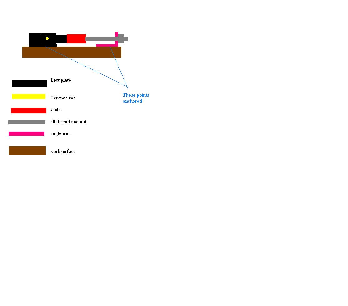

That's the basic idea, but im not sure if it will work. What is the purpose of the spring? How are you going to measure shear strenght? Can the plates slide past each other? The picture I posted was a top view.
Edit add picture and spelling.
- side view
- sheartest.JPG (31.42 KiB) Viewed 2886 times
I am aware that what I just built needs to be modified to work (Doh!). Unfortunately, no fish scale that I know of can simply be attached to a steel plate and a threaded rod, so that's the spring from one.
EDIT: And that is why I'm waiting until tomorrow to test. I can't think straight at ALL.
