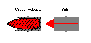

Recently I have been thinking about trying to develop a paintball bullet.
I want to see how to improve the accuracy, velocity and range of paintballs, not so much to be used in tournament though. To do this I need to turn the ordinary paintball into a paintbullet to improve it's aerodynamics. I'd also like to try incorporate rifling which is a bit tricky.
I expect they will have to be made of gelatin like ordinary paintballs. They could be formed like a noraml paintball as such http://www.youtube.com/watch?v=gneZc_hafDE only with a half bullet shaped cast instead of a ball. This is fairly simple in theory.
Next I need to develop a rifling system. This is the tricky bit as the bullet will be subjected to high forces when fired and I don't want it to burst inside the barrel, and a rifled barrel doesn't allow the bullet to disperse its surface tension evenly along it's walls, increasing its chances of bursting.
That's where I thought about placing the bullet into a two or three piece sabot round like the picture attached. The two points on the edges are to slot into the grooves in the rifled barrel. I want to build the barrel so that that near the action where the bullet is loaded, the barrel opens up slightly like a flange so those two points can slot into them by themselves.
The only problem I see is that the sabot round may not come off the bullet straight away which would affect its accuracy. I need to figure out a simple way of getting it to depart from the bullet as soon as they leave the barrel. That's my main concern really.

- Sabot.PNG (2.55 KiB) Viewed 5837 times
didnt read your whole post but do you mean something like this?

Yeah something like that. Theirs is really interesting. Cheers for that.ilovefire wrote:didnt read your whole post but do you mean something like this?

Very True. I haven't done much physics since high school to be honest so I'm a bit unsure here. What would likely happen if I tried to make it spin? If I put a divider down the middle of the bullet to create 2 sections forcing the liquid to spin, would that make any difference?jackssmirkingrevenge wrote:The only problem I see is that the sabot round may not come off the bullet straight away which would affect its accuracy.
I would be more concerned about the fact that you're attempting to gyroscopically stabilise a projectile with a liquid core.

you can try your self with a egg spin a boiled eggs and compare its time with a raw egg

With the liquid however, if I put a divider down the middle of the round wouldn't that solve the issue of the bullets liquid centre not gaining inertia when fired?
Technically yes, but it also complicates manufacture.With the liquid however, if I put a divider down the middle of the round wouldn't that solve the issue of the bullets liquid centre not gaining inertia when fired?
