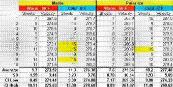

This test uses layers of paper box-o-truth style to check out frozen paintball penetration, with unfrozen ones for comparison:
Terrible music but the data is there.
The youtube page suggests the data can be dowloaded but the site looks trojan rich to me, have a screen cap from the video:
