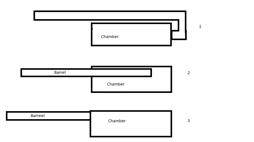

As i have build my pvc spudgun, after few shots, i was worry about the safety of my gun.
So can anybody tell me a more or less precise pressure of a combustion gun is able to produce. most of people told me a pressure between 6 to 8 bar.
If that´s true, is that safe to make a gun with a coke bottle? because I´d like to make a clear combustion, they looks very cool but I can´t get any clear PVC.
And by the way here are some most common designs, can anybody tell me their weak points? witch of them is safer?
Thanks
My gun is the 2 type, co-axial.
Sem Título.jpg (29.93 KiB) Viewed 2585 times

A coke bottle should be fine for a 1x combustion.
I don't know about 2 and 3 but for the first one here is stress on the elbows if you dont have good barrel support.

A coke bottle should be fine? That's great news for me :) about the 1 design i thought the same thing. Any idea about the rest and the pressure a combustion can produce? Thx

The max pressure a metered combustion can make I think is around 120 psi. With a properly connected coke bottle, such as in this one, you will probably be fine.

I wouldn't recommend drilling any holes through the soda bottle, unless its through the neck. Also, I don't know where you live, but some European countries have bottles that are meant to be reused; those bottles are much stronger, so depending on where you are, you should try to get one

Yeah, drilling through it is never good; use a tee or something to attach a fill valve.

theres a combution cannon somewhere on spudfiles, were someone used normal white pvc. Cut a window in one side and covered it in clear plastic. Held it down will lots of screws around it.

I won't drill any holes on the bottle, and actually i found a type of bottle (from a drink) that's feels much stronger than normal coke bottles, probably i will use it. I thout the idea of cut a window on pvc tube, but i was worried that will weak the chamber. Thanks for help :)
