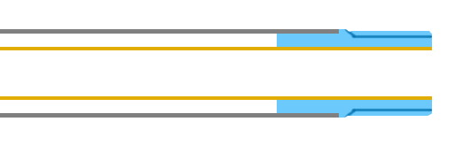

Taking into account that you said you wanted to thread the end, which suppose you need some thickness in the tube wall you'll use to thread it, this would be my way with two tubes you could find, whatever their wall thickness.
With a drill press and a file you could do this simple shape.
Blue piece could be brass (easier to thread) or aluminum. If you manage to find a brass bolt of the proper thread and diameter, you could even just center drill the bolt to the OD 6mm tube then epoxy it inside the ID 10mm tube.
