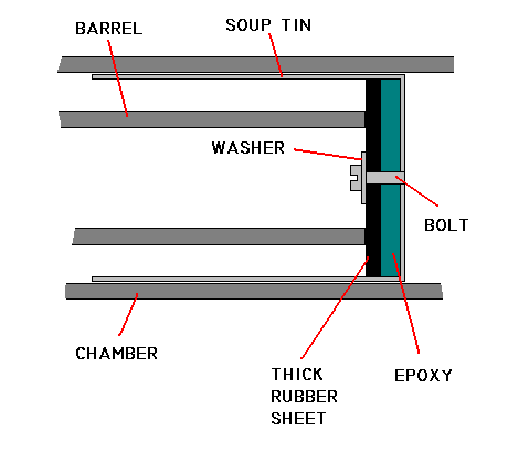

Hello right now I have an old soup can as a piston for my 3" piston valve I have been debating wether or not i need to fill it with something and was just looking for opinions on if I should or shouldn't and if so what to fill it with

Hi,
Piston as a soup can?
Reason being is because the dead space inside the soup can will add up with pilot valve area, resulting in a under performing valve.
Mind that you would want to keep the piston light as possible, So i would recommend Foam or other type of light material
Good source of light material is Styro foam or the meat tray package, and maybe even the kids playing mats work well.
Answer would be yes.debating wether or not i need to fill it with something

Thanks I appreciate the help and ya it fits perfect in side the vale haha
Here's how I would do it
- souptinpiston.png (4.01 KiB) Viewed 3501 times
