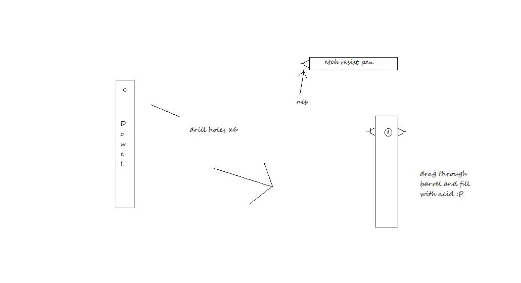

would this be faster and re-usable
etch res pen method
etch res pen method
etch r barrel dwl.jpg (19.75 KiB) Viewed 12071 times

I don't think this will work very well at all. Coating the surface of the metal with wax will not prevent an acid solution from attacking the underlying material.
I got some good results with just masking tape here.
