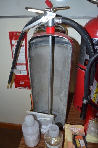

Here is example of extinquisher as chamber.
http://www.spudfiles.com/forums/viewtop ... tml#236916
Note internal construction:
