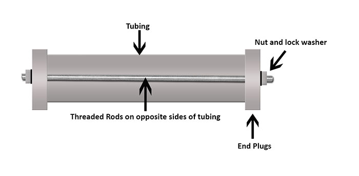

I had a similar idea with making end plugs with o-rings on them because of the weakening aspect of welding. But I was thinking about connecting the two ends together with a couple of threaded rods like the drawing below.
If the cap screws would work and not sufficiently degrade the integrity of the tubing, I would prefer to use the cap screws. I could also put washers under the head of the caps screws to further reduce the stress.
I saw that McMaster has the low head, self-locking socket screws They call them Button Head socket cap screws. Link: http://www.mcmaster.com/#socket-head-cap-screws/=o9fffn. They're toward the bottom of the page.
