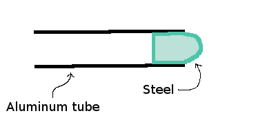

My idea right now is to use thin walled aluminum tubing with a steel lug at the end, like my attached image.
I am not sure on weight right now, as I am in the very early design stage. Is GGDT still around? I might have it archived on an old harddrive around here some where....

Might want to crimp that tubing on there rather than epoxying it. Hitting a hard surface at high speed is gonna put the joint under quite a few thousand g's of shearing force.

Good call. Do you think the acceleration in the barrel will blow the steel out? Or are you thinking once it hits the target?

Think about it. You take a mass and accelerate it to, say, 500fps over one meter. Then you suddenly decelerate it to 0 fps over one centimeter. The shock of impact is easily greater by orders of magnitude.

Agreed. But leaving the tube behind on impact is relatively unimportant, as long as it sticks on to stabilize during flight.

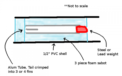

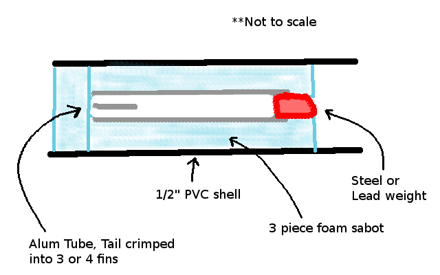

It looks like there is no denying the power and efficiency of a sabotted dart, which will also require the use of a shell. Which means I can't get too exotic with barrel choice, or my shell cost will go through the roof.
I am thinking some sort of polyethylene cylinder purchased in the appropriate size so I just need to bore a hole in the center and slit it in half, as shown in the provided doodle.
Also, the forming of the aluminum pipe into tail fins using a 3 or 4 jaw chuck is simple yet effective- Perfect.
Any thoughts on sabot material/production?

A foam sabot will shred in the barrel.
Trust me :)
If you're making a hybrid, I don't think saboting your rounds is really necessary. Unless you're really fixated on penetrating thick steel plates, a full bore slug from a hybrid will go through most discarded domestic appliances spudders typically shoot at ;)
