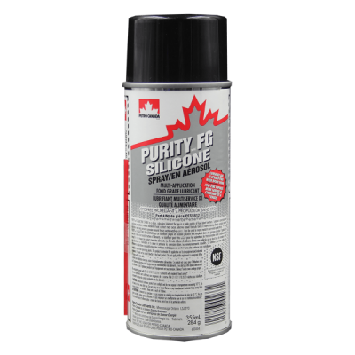

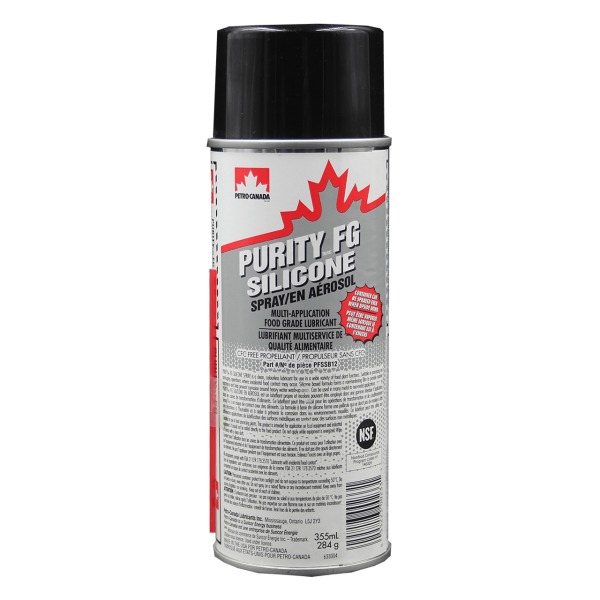

I would say anodize if you can afford it.
If not, I spray my aluminium with silicone spray, it dries and forms a coating that somewhat stops oxidizing and lubricates.
