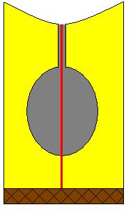

How about this?
The yellow is the form, the gray the cavity for the projectile, the red is the slice, and the brown is a corrugated cardboard disk.
The foam is sliced and then glued to the cardboard disk
Call me "Judge", it's easier to type.
Spud gun safety rules

Judgement thats not making much sense to me. If the halves are glued to the cardboard then there is a good chance the ammo wont even leave the sabot and the whole thing will be gone, unless thats the point of it.
Fri Dec 08, 2006 6:13 pm
Any sabot i ever seen only incases the bottem half of the projectile, it's a useable design, but i don't think it would be consistently the same shot after shot. It would shoot as wildly as the 1" super balls i 've shot, one curves off the the right, the next one travels straight away, then curves straight up! The unknown makes it fun!

Most sabots are not reusable, as a mater of fact I can’t recall ever hearing of a reusable sabot. The cardboard is used to keep the whole thing together the round will still separate unhindered. I’ve done my research I know what I’m talking about.
