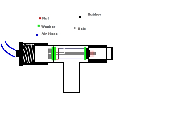

heres what mine looks like:
-uses rubber washers instead of o-rings.
piston
piston

Using Chaos's design, you would not need to purchase a neoprene sheet. If you have a different design in mind however, I would suggest something like:
