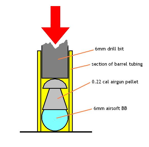

Adapting 0.22 airgun pellets for airsoft barrels
Tue Apr 03, 2007 9:17 am
It's pretty self explanatory, a couple of light hammer taps on the drill bit and you've got a good fitting heavy projectile that will still fly head first out of a smoothbore barrel due to the shuttlecock shape. If you can find 0.25 pellets, they'll fit in a 6mm barrel without modification.

Why do you need the drillbit? Are you just drilling out the first inch or so of the barrel, or what?
And what about putting a little toilet paper behind the pellet? That would seal it pretty well, and be cheaper. Plus, it would likely fly faster since the gun doesn't have to accelerate two projectiles to such a high speed, just one...so it would fly faster.
I'm weird, I know it, you don't need to tell me.
Tue Apr 03, 2007 11:22 am
You don't specifically need a drill bit, just a 6mm rod you can tap on the pellet's head with - and the BB doesn't actually stick to the pellet, it's just there to flare out the skirt of the pellet to match the inner diameter of the barrel.

Ok, so the BB doesn't even get fired, it's just there to help form the pellets base? That makes sense now. Although, I still think a simple sabot would be easier, like just a little wad of TP behind the pellet.

pyrogeek wrote:Although, I still think a simple sabot would be easier, like just a little wad of TP behind the pellet.
This would be simpler, but since the pellet wouldn't be an exact fit in the barrel, it would tend to bounce around and fly out of the barrel erratically.
